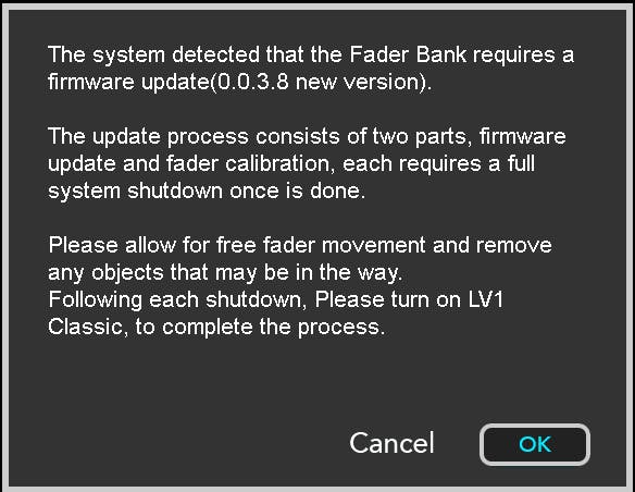

  1. If a new Fader Bank firmware is available, you’ll see this message when powering your console on. Make sure to disconnect ALL external devices and control surfaces, then click OK to proceed.

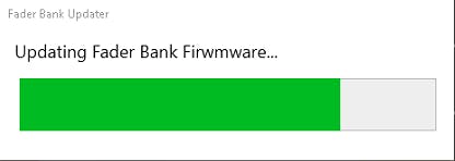

  2. The Fader Bank firmware update process will begin.

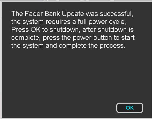

  3. Once done, click OK to shut down the console.

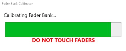

  5. The Fader Bank will now begin a short calibration process.
    features
    Do NOT touch the console during the calibration process.

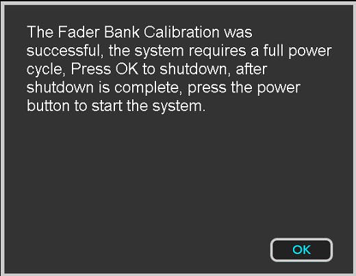

  6. Once done, click OK to shut down the console.
